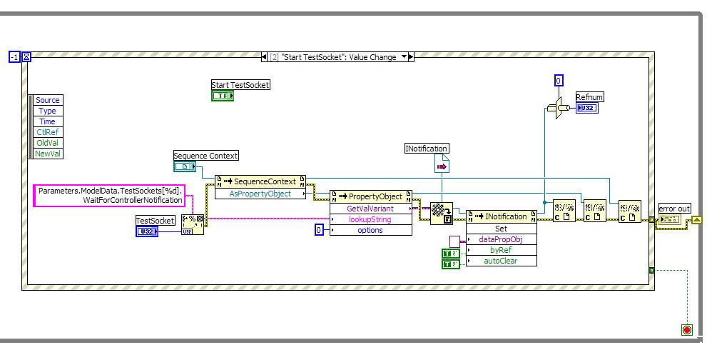

Richard,
I was able to set a notification to kick of a parallel testsocket by modifying your example.  It actually will simplify it a bit.  Don't bother with storing the references in an LV array.  Just access the references from teststand when you need them.  What I did was to modify your example and you only need the PreUUT callback and a modified version of StatusWindow.vi.  Call the sequence that contains the StatusWindow.vi with it set to run in a separate thread as before but call it from the PreUUT sequence before the wait.  Set the sequence call with a precondition for testsocket index of zero so it only runs once.  Also, modify the sequence to have a parameter for the modelData container, same parameter as the PreUUT (copy and paste it from the PreUUT parameter).  Then you can get the notification references from the sequence context in that sequence.  If this is set up correctly you can modify the VI as shown in the picture and be able to set the notification.
I'll see if I can clean up my files so you can get those...
Paul

Here is my example code.
I deleted the last close reference that is shown in the picture in my last post...
Also, the VI needs to be open, it is not set to open the front panel on its own.
Issues: I don't know what will happen when TS 0's PreUUT runs again, nothing is preventing it from running the new-thread-sequence.  I don't check to see how many testsockets are initialized. Plus I am sure there are other things that aren't being considered.

Hi Paul,
Very nice! Thanks
regards
