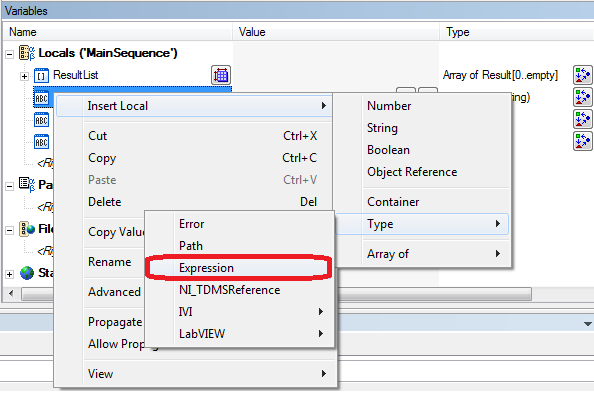

It is a basic question but I do not found any documentation about the variable type expression.
What is it for?
Teststand 2013

Add this variable to the test sequence.Its just a string type.
They are predefined variables types.
For example : Error type is compatible with LV Error type.
i.e. for an error output from Labview you can connect to a variable of type Error.
Similarly Labview waveform data types.
Not sure where expression is used...but from a TestStand perspective its just a string...same like Path.
Hope this helps.
Ravi
(5,259 Views)
The variable type Expression (String) is similar a simple "string" as you said, but add a validation to the "string" as a expression.
Maybe this is the main diference.
