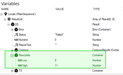

Regarding result collection:
when executing a NLT without process model, the result container contains only RawLimits
When using the process model, the Result container also contains a Limits container
so obviously, the process model adds the limits container to the result container.
Where does this magic happen? At least in the Sequential Model, it is no ProcessModel Engine Callback, where I would've suspected this to happen
