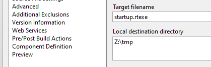

I had this problem today too.  Not sure what the path limit is, but I shortened the build path to something almost ridiculously short (Z:\tmp) and the build was successful.

oh - I should have specified:  I encountered this problem while building a real-time executable (*.RTEXE) within the LabVIEW project.

Windows is limited to 260 chars path length. Shorten folder names and/or Subst command to shorten it further.
Subst g: "C:\program files(x86)\National Instruments\Labview2021" will save you some 55 chars ...
