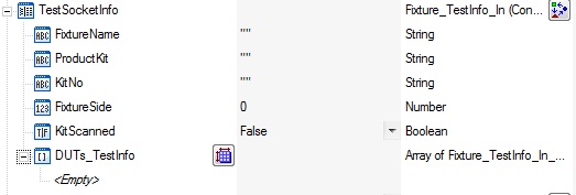

What I need to store there are such containers:
They look like this as LV clusters:
I hope I can store containers In RunTimeVariables also (not only simple types like strings or numerics) or is it impossible? Tomorrow I will take a look at TestStand API, how to hadle containers. I got a feeling it will be a burdensome work to maintain them (fill / remove / read).
