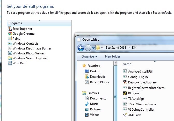

Thanks but when I tried this, Teststand does not show up in the list.
I also tried to right click on one of the sequence files and set what opens is but
not sure what teststand file to select for this...

Do you want it to open with the sequence editor or the user interface?  If you want the sequence editor then you use the <TestStand>\Bin\SeqEdit.exe
If you want the UI then you would need to go to <TestStand>\UserInterfaces\Full-Featured\LabVIEW\Source Code\TestExec.exe
Look at the pictures.
If  you don't have either at those places then you need to find which UI you are using and the location of TestExec.exe.

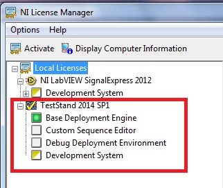

sure if this has anyting to do with it but how can I remove the
TestStand 2014 SP1 Custom Sequence editor, Debug Deploymrent  environment,
and Development system from this PC?
it only give me the option to activate these and I wuld like to remove them
thanks

By default, sequence files are associated with a sequence editor launcher executable (not seqedit.exe) that handles opening files in an already opened instance of sequence editor if available.  this EXE is located here:
<National Instruments>\TestStand 2016\Bin\UseExistingSeqEdit.exe
Regarding the custom sequence editor and debug deployment environment, these are not seperate software but different license levels that are available.  The white square indicates that you do not have these active.
Al B.
