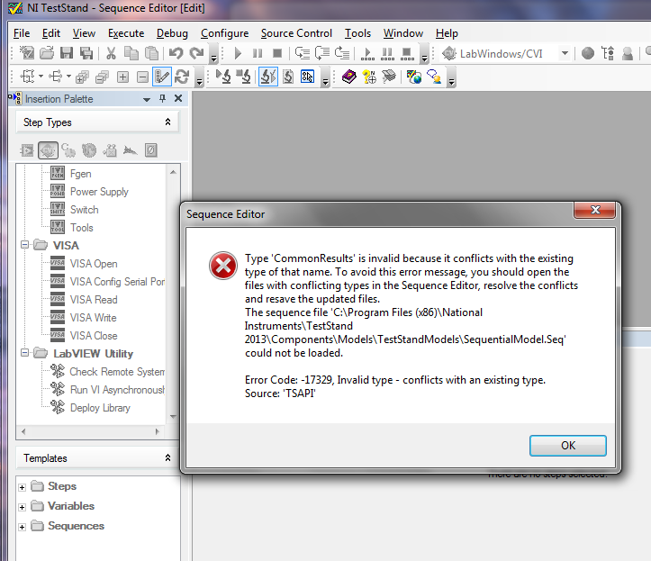

Thank you Daniel-E for responding, I followed your instructions and I am still getting the following errors and do not know what they mean or how to solve the issue. Again thanks to anyone who respondes.

Try just selecting "Use Type from NI_VISATypes.ini" and hitting OK.

Hello all,
I've been investigating this a bit to figure out what could be happening. I haven't completely figured out the root cause, but I did find a report in our system suggesting that the example can hang for newer versions of VISA. The workaround we have for that issue is to disable the VISA PXI passport as follows:
1) Open NI Measurement & Automation Explorer
2) Go to Tools > NI-VISA > VISA Options
3) Click on the Passports section on the left side under General Settings
4) Uncheck NiViPxi.dll - NI-VISA Passport for PXI
This seems to resolve the hanging issue. I'm still looking into it to figure out why the issue is happening, but let me know if this works for you or if you still encounter issues after trying it.
As far as the type conflict you saw when originally opening the file, I would recommend choosing to use the current type (the newer version). The CommonResults container shouldn't have changed, but it is better to use a newer version of the type where possible. After choosing this option, you will likely be asked to save the type palette with these changes. After that, you should not see the type conflict dialog again.
