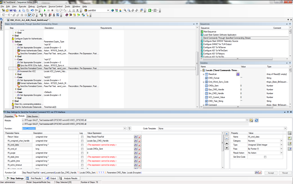

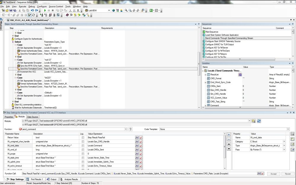

This is a TestStand generated error. The laptop is the one that has been used during the entire time of the program. I do not know of any network changes but I am also not sure how that would affect the TestStand code and variable passing. This same code has been used since its initial development in 2008 and has been under CM control. This is occurring across multiple platforms. The two laptops used to test the system during its life time and on my office system that was used during development. Although I currently run 14.0.1.103 on my office system. The code had not been used or loaded for around two years then when brought up to try and run a regression test the analysis error occurred for the prototype not matching. The calling C++ code is looking for unsigned long inputs while the TestStand sequence builds a custom data structure. The structure was always passed in by pointer and was never an issue until the code was brought up earlier this week. I have attached screen shots before and after the prototype reload.

It looks like the IN_cmd_data types don't match between the working version and the broken one.  I noticed it looks like is may be a custom data type: rt_logic_Base_BitSequence_struct_t   in the working version, but in the broken one it is set to Unsigned 32-bit Integer.  Are you able to set that data type to match the old custom one?
