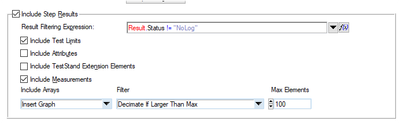

Then, in the report Options plugin set the Result Filtering Expression:  Result.Status != "NoLog"
So, the re-tested Steps will always have "NoLog" and will not be logged.  Passed and Failed tests will be in the report.
