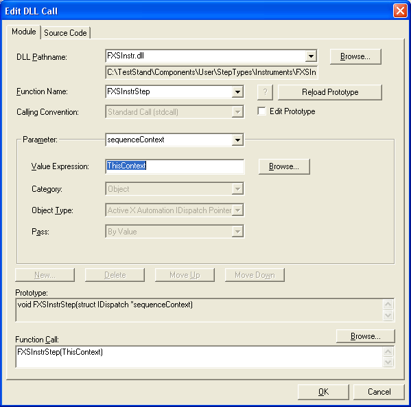

I do nothing but call VIs made into dlls. In the build spec, the sequence context is defined as IDispatch Pointer and in TestStand, I pass it ThisContext as the expression. I also use Standard Calling Conventions when I define the VI prototype.

I understand I need to identify it as an IDispatch in LabVIEW but in Test Stand, do I pass the sequence as the following:
Category ->  object
Type ->       ActiveX IDispatch Pointer
Pass ->       By Value
Thanks for your help.

Yes. Here's what it looks like in TestStand v2. It appears to work the same in 3.x.

    Thanks so much. All works well now.
