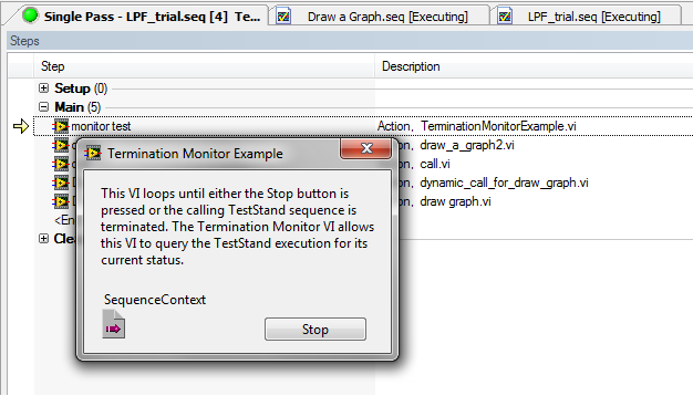

I have used the VI you attached. I called in my own TestStand sequence. Although I did not get desired result - the window poped out but the test waited till I press stop button, the sequence execution did not proceed.
http://i79.photobucket.com/albums/j122/thor_tory/1_zpsf0b51954.png~original
Michał
Message 8 of 11
(6,171 Views)
OK, I set it as a new Thread and it works! Although one thing more, is it possible to generate the report too, now entire test goes to the very end but the report is generated after that new thread is closed. Is there anything to be done in that issue!?
