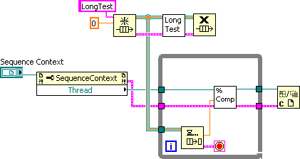

Here's a simple example of what you could do. A queue is created and in the bottom while loop, the queue is read and when the queue is released, the while loop stops. The percent complete could be obtained from the Long Test subVI since it can write to the queue. If the Long Test subVI cannot write (i.e. in the case of a self test going off and taking x amount of time, use a start and stop time in the bottom loop like the shipping example does.
