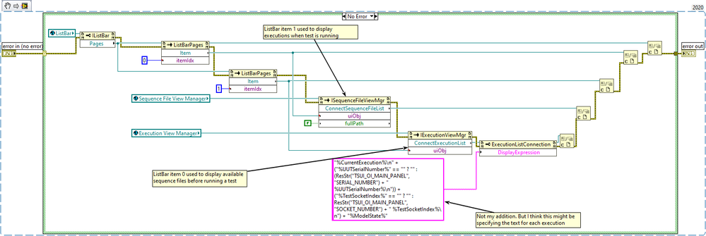

The below code might help you. It runs at initialisation only. The OI itself is used with a Batch Model. The code also has a callback setup, that gets executed upon the "DisplayExecution" event. Where it takes the execution reference and passes it into the Execution View Manager, plus it sets the current page of the ListBar to 1.
So when a user hits the "Test UUTs" button, 4 threads become visible in the list bar (1 main and 3 for test sockets). Whenever the user clicks on one of those executions, the Execution view changes to reflect the selected socket. Hope that's what you need!
