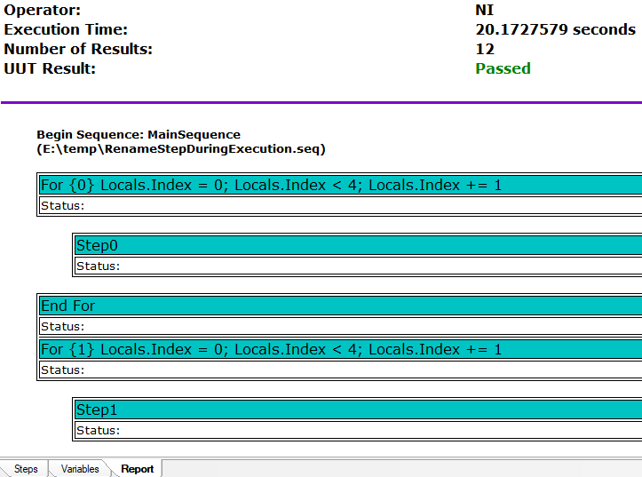

I cannot reproduce the issue you describe. Please compare with attached code.
Norbert

Just replace the Statement step with a Wait. Copy the expression you had in Statement and set the wait time to 5s.
When you run the sequence then you'll that in the first iteration TS displays "Wait" and not test0, then in the 2nd iteration it will display test0, while it indeed executes "test1" etc.

Nope, works as expected. There is something different wrong on your machine...
EDIT: Ah, i see... your statement does not refer to report, but to the execution view.
Point is that tracing only updates the position of the execution arrow and the step which has just executed. Because of this, you won't see any modification of "future steps". To work around this, you can manually send an UI Message "Trace" in the renamed step after renaming has been done.
