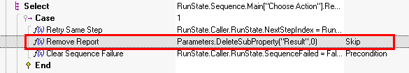

This example is implemented such that upon clicking Retry, the data for the previous execution of the sequencecall is removed from the ResultList. If you want to avoid this behavior and would like to see each failed attempt as well as the final passed attempt, you should skip or delete the Remove Report step from your sequence (see screenshot below). This step deletes the previous sequencecall data from the ResultList. If the data does not exist in the ResultList, the report generator has no way of including it in the report.
Hope this helps.
