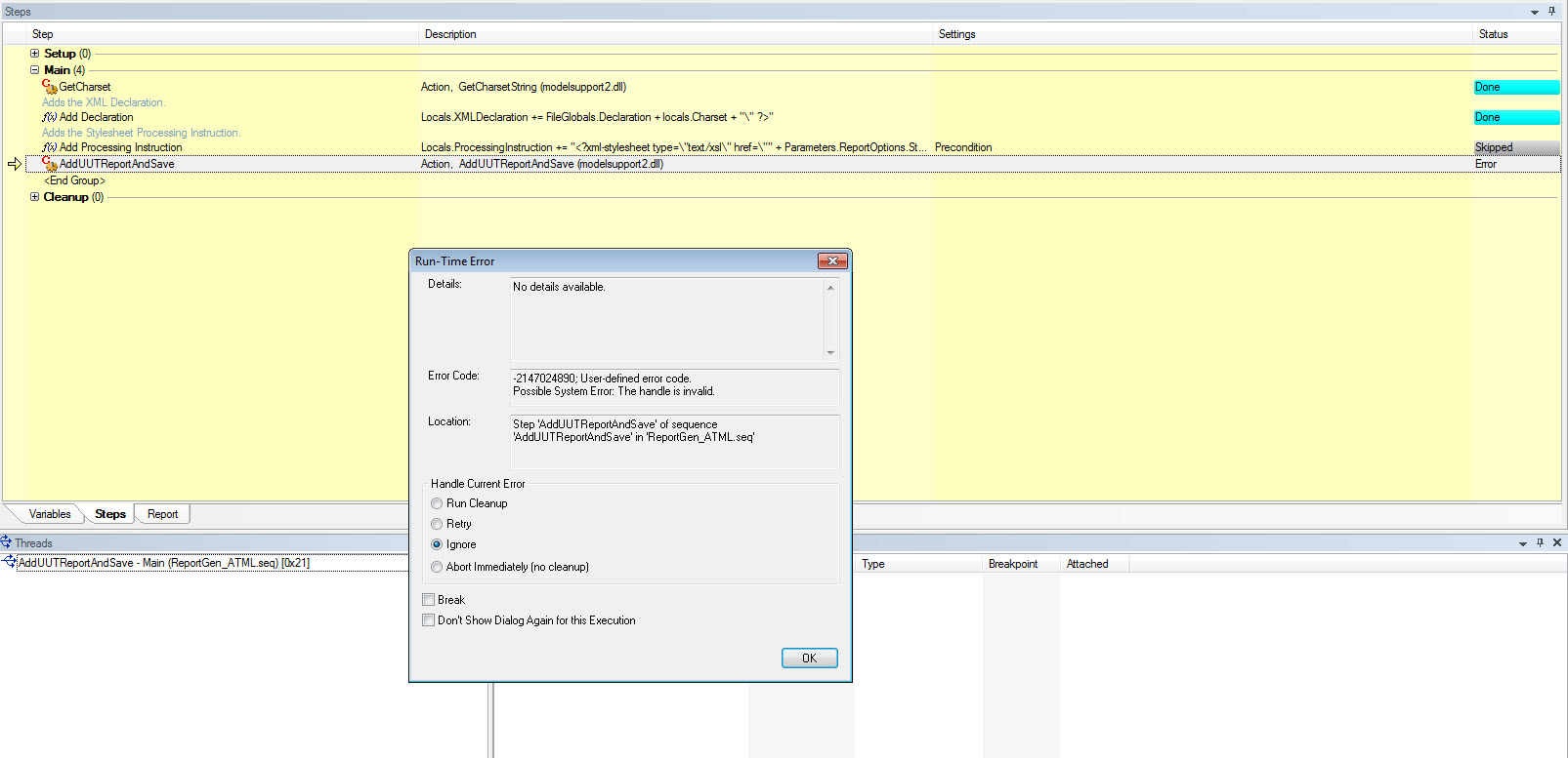

Hi Al,
I am having the same issue and I don't know how to resolve it. I have tried the step you suggested in this post but still could not resolve it. Please, can you help
Stan.
(4,674 Views)
HI Angel22,
you dont need the step AddUUTReportandSave.
Because TestStand would generate alway a Report. You need only set the file path.
So, you should add a "sequence file callback" - "ProcessCleanUp" in the Sequence window.
And than use the "Report.Save" Methode to set the "Report File Path".
It should work.
Regards!
