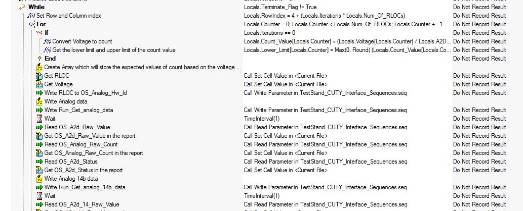

This issue is consistently occuring. Below the snapshot of the seqence which I am running.
Please note that the sequence executes perfectly fine. No issues with that. But, if someone selects "Read Parameter" step and "Set Cell Value" susbsequence call step together, at that time I am getting this run time error, which I had mentioned in my first post of this thread.
The "Read Parameter" is a customised step which we are using to read the value back from ECM. I am attaching the sample sequence file with this post.
Since I just copied few steps from the original sequence, and pasted in the attached sample test sequence, the test is not executable. I havent created necessary locals as well.
You can simply open the sequence in TestStand, and once you select "Read" step with "Get" step, you should the run time error popping up.

Thank you for attaching the sequence file. The problem occurs when you select two steps that have different values for the TS.CanEditModulePrototype property. Your custom step type has a value of False and the other SequenceCall steps have a value of True. You can workaround the problem by editing your custom step type as follows:
  1. On the Step Type Properties dialog box, select the Disable Properties tab.
  2. Uncheck the Edit Module Prototype checkbox.
This problem will be fixed in a future version of TestStand.
