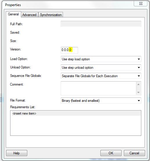

Hello again,
I took a dig through the TestStand 4.2 help and found this article. Is this the method you are using to increment the version number? And if so, do these numbers help?
Thanks!
Rhys

Yes,
That is what I'm using. My value is set to 3. And it works fine, but I have something extra with that. Along with auto incrementing Revision component, the Build component it reseted to 0. I don't want the build component to be reseted back to 0 when the Revision component is incremented.
