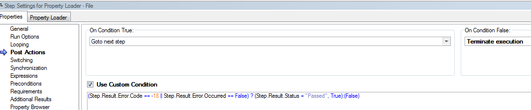

If you set the Property Loader step to "Ignore Run-Time Errors", the error dialog will not appear. This allows the sequence to execute, but as you mentioned, the Property Loader step will display a red "Error" step status. To change that, we can use a custom Post-Action on the Property Loader step. See the following screenshot:
This custom condition sets the step to "Passed" as long there was either no error or the error code was -18 (which is the error we see when not all of the steps are in the sequence file). If any other errors occur, the sequence terminates.

Hey Daniel,
Thank you for your workaround. I only had to change the post expression a little bit, because if I set the Ignore Runtime Error the 'Step.Result.Error.Occurred' is always FALSE, only the Error-Code is set correctly
(Step.Result.Error.Code == -18 || Step.Result.Error.Code > -1) ? (Step.Result.Status = "Done",True):(False)
