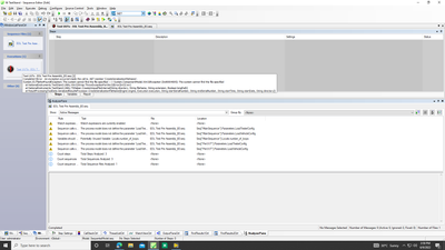

I am having this error each time I try to run a sequence
Completed Error An exception occurred inside the call to .NET member 'CreateSerializationFileName' System.IO.FileNotFoundException: The system cannot find the file specified --> System.componentModel.Win32Exception (0x80004005)
Any idea how to fix it?
System was working ok but after a reboot it is not working anymore.
(3,582 Views)
Seems that TestStand was running without admin right and trying to do changes on C drive
