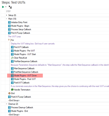

Still, hope is not lost 😉 UUT Report is saved to disk during the ModelPlugin - UUT Done.
So you could go and add some functionality to the PostUUT Callback: copy over the latest file from TestStand report directory to another directory, which is monitored by your FileWatcher.
