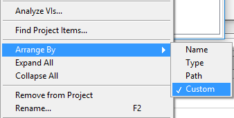

Kyle,
I'm referring to this help topic.
If you have this property set to 'Custom' it will alter the layout on disk. Switching this to 'Name' can help with load times.
-Trent
https://www.linkedin.com/in/trentweaver
(4,849 Views)
Ah, thanks.  I was looking for an option to change the sort inside of TestStand (and failing) so I wasn't thinking you were referring to the sort order of items inside of the LabVIEW project.
