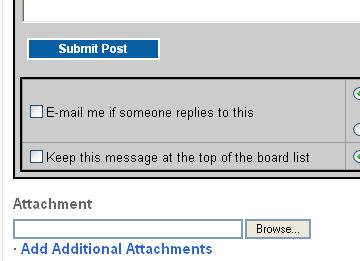

In the Post Message window, you should see a control to allow you to attach a file.

Ray,
And I've tried numerous times to browse to the file I want to attach and it then appears in the edit field and nothing get's attached.
Perhaps it's a permissions thing.

Don't preview your post before posting. This removes attachements.

Wow, that's certainly intuitive. Smiley Mad
Thank you.  It seems to work unless editing the post also drops the attachments.
OK, that seemed to work.

Just to clarify in case someone else reads this. Don't preview a post after adding an attachment. It seems to drop the attachment.
