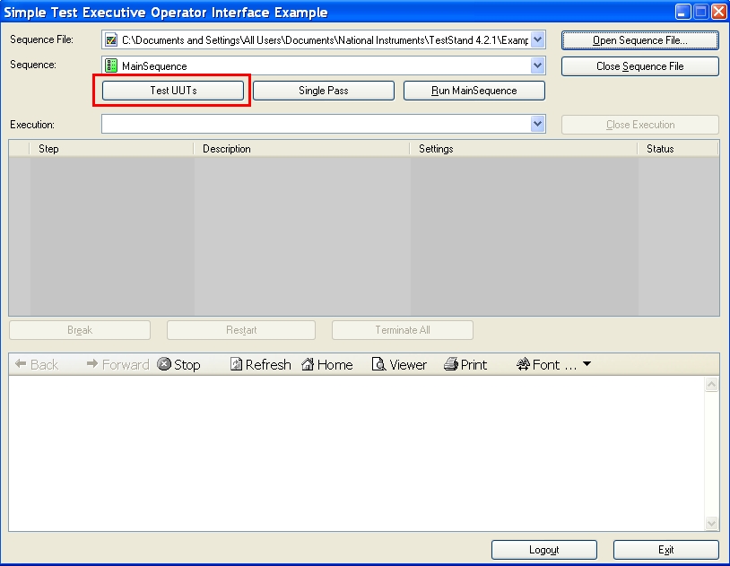

For example, in design view (refer to screen-shot 1), the button "ENTRY POINT1" has no event handle associated with it. When I ran the program, this caption of this button changed to "Test UUTs" (refer to screen-shot 2). And after I loaded a sequence file, and click this button "Test UUTs", the sequence carried out its tasks happilly just like ran from the Sequence Editor. How did this magic happen?

Leo,
the reason is that this button is no C# button, but an ActiveX container containing a specific TestStand component (type: "Visible control 'Button'").
Therefore, this container already encapsulated a lot of functionality, which is "running in parallel to your C# application".
In order to make your UI work correctly with the container, you have to "connect" the control to a specific function. This is done in the code line:
axSequenceFileViewMgr.ConnectCommand(axEntryPoint1Button, CommandKinds.CommandKind_ExecutionEntryPoints_Set, 0, CommandConnectionOptions.CommandConnection_NoOptions);
Well, that's all you need to make this button control to work as a "start button for your sequence execution" (including labling).

Hi Norbert,
Thanks for your reply.The code makes more sense now Smiley Very Happy
So for "Test UUTs", the axEntryPoint1Button control is connected to execution entry point 0. Then the default caption for this button is "Test UUTs".
With the same logic, for "Single Pass", the axEntryPoint2Button control is connected to execution entry 1 as shown below:
axSequenceFileViewMgr.ConnectCommand(axEntryPoint2Button, CommandKinds.CommandKind_ExecutionEntryPoints_Set, 1, CommandConnectionOptions.CommandConnection_NoOptions);
