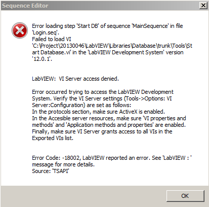

In the middle of running some TestStand sequences, calling LabVIEW code, I lost connection to the VI Server, and started getting the attached error:

Each of which had a couple of KB articles referenced, but those steps do not solve the issue. All the VI Server items are enabled on LabVIEW (and were working up until a couple hours ago). I restarted everything, but I keep getting the same error.
this is TestStand 2012 SP1 f1 (5.0.1.66), and I installed the recent patch, as that was alluded to in several other posts.
It is communicating with LabVIEW 12.0.1
What other issues might be causing this V Server error?

In this case, it was the exact same step (with the same VI) that went from working to non-working.
The difference that was made was that I started pointing to the project first, and then the VI, rather than directly to the VI. When using the project, the VI Server settings on 'My Computer' target were actually overriding the VI Server settings in Tools>Options.
So, the solution is to make sure the Project> My Computer>Properties> VI Server settings (machine Access, exported VIs) have the * in them, in addition to the general LabVIEW settings.
