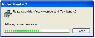

Whilst executing the test sequence, in the sequence editor, I get the following dialogue boxes:
The message appears just as an IVI DMM step type is to be executed.
This step has not changed recently.
If I select Cancel, the displaying of the messages occurs 2 - 3 times
again, but eventually stops, and the sequence execution continues
with no problems.

I've found that by creating an entirely new sequence file/main sub sequence, then adding just a single IVI DMM
or Switch step, then selecting Edit the step, the error messages appear.
If I persist in cancelling the error messages 2-3 times, the IVI edit panel eventually appears, allowing me to continue
as though normal.
