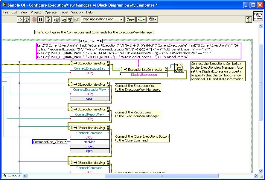

If you are using the LabVIEW OI, this code can be modified by going to the Simple OI - Configure ExecutionView Manager.  It would look like the following:
You would make this modification, build your executable again, and run it.
