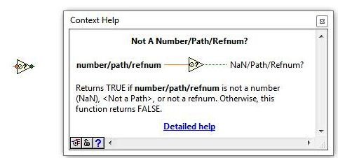

Hey Eximo,
This seems more like a programming issue than a TestStand issue, but if you are using LabVIEW as your code module you can use:notanumorrefnum.JPG
or
hope this helps.
BeauH
Applications Engineer
(3,495 Views)
That may work.....but i'll just copy the code from the vi, maybe the use of a status to boolean will keep suppress the error, the biggest problem is if I use anything to check to see if the error exists, it causes an error, and stops the progress of the program.  I'll try and see if that works
