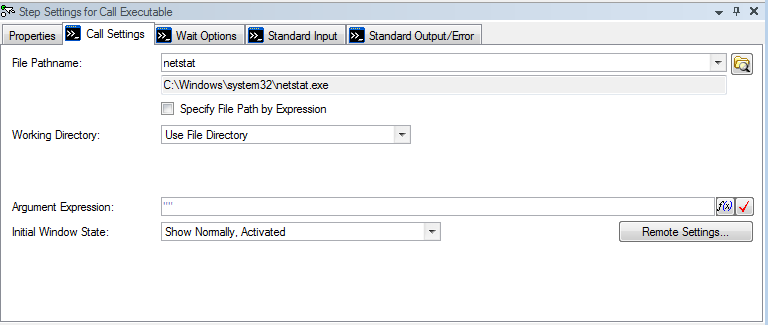

For commands that have their own corresponding exe, you don't need to use cmd.exe at all. Just call them directly from the callexecuteable step. For example:
cmd.exe is only needed if you need to issue a command that is builtin to the cmd.exe and not an exe of its own.
