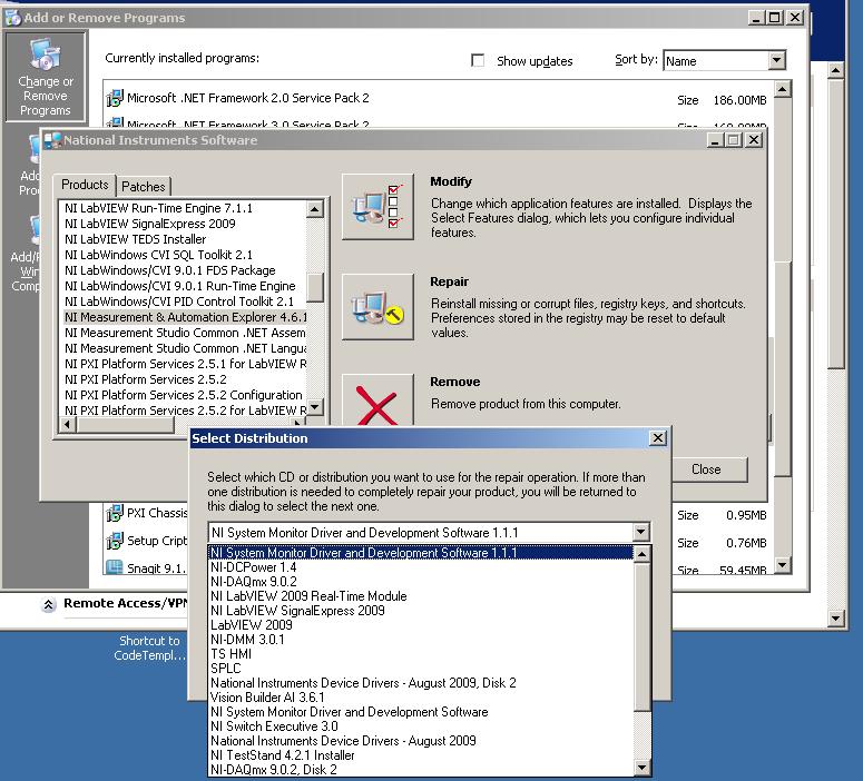

Secondly, if this assumption is correct, how do you repair this? I tried to repair MAX, which asked my which component I wanted to repair. Not quiet sure which component the report generation function is under:
