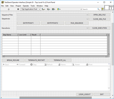

Hi Raymond,
I only indicate what i wanna show by using UI msg to update the info to my OI. However, i lost the link. I found it in this forum is some old post.Untitled.png

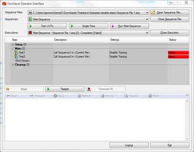

simple ui - disable tracing.pngThis is a screen shot of the default simple UI supplied with TestStand 2014.
With the SequenceCall steps diabled tracing as outline above, all I see is the two top level steps running.

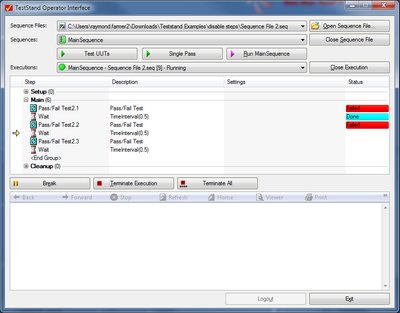

With one of the steps set back to tracing, then I see the steps in the SequenceCall.
I have dont nothing in the UI to achieve this.
