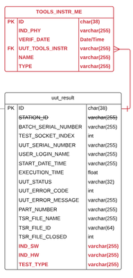

For my next project, i want to use the result processing database (First time). I started from the teststand model and did some  changing on it.
I added a tools table to save the tools used on each UUT. Every UUT use more than one tool.
I set the statement as below
The problem with this configuration is that i can save only one tool.
I don't think there is an sql request that can add a dynamic table (the number of tools is unkown).
Is there any way to save a table with the "apply to"  parameter set on "UUT result"?
Or am i missing something on the result processing database tool?
Thank you in advance
