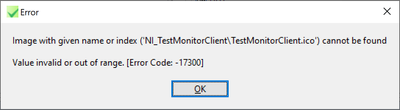

I am now seeing a similar error:
I renamed the file ResultProcessing.cfg and restarted, and this still happens.
The ico file mentioned doesn't exist in the program files components or the one in the Public folder.
Make sure you have the systemlink client installed properly with support for TestStand.  That plugin is for the SystemLink.   If you open the ResultProcessing.cfg file in a text editor and search for TestMonitorClient.ico do you see it in there?  If so you didn't rename the right file.
Also, try renaming the Addons.cfg file as well, in the same folder as ResultProcessing.cfg, and restarting TestStand.  I want to say SystemLink puts their stuff in the Addons.cfg file.

Thank you!  I did a quick search in our docs for Systemlink and found the guy who set it up.  Turns out he abandoned things and they weren't properly installed.
In the end, I edited the XML to remove the icon and removed the offending entry from the result processing.
