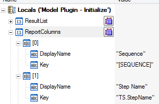

You can use the ModelPluginConfiguration callback to make modifications at runtime to the Simple Text Report plugin. In the attached image, you can see that through this callback I have access to the ReportColumns and their names, as well as other various properties, like ProcessOnTheFly.

Thanks, this is slowly making more sense to me, I feel as if I missed a chapter in the manual.
Is there a list of the available key values, I have found Numeric,Limits.Low and Limits.High but I also need the type of test ie <GELE>
For non numeric tests I get a lot of <MISSING> strings in my report, I can see these are added by the ProcessOneResult function in Reporter.c of the SimpleTextReport cvi code. But I do not see how to get the results and limits from a string test into the report.

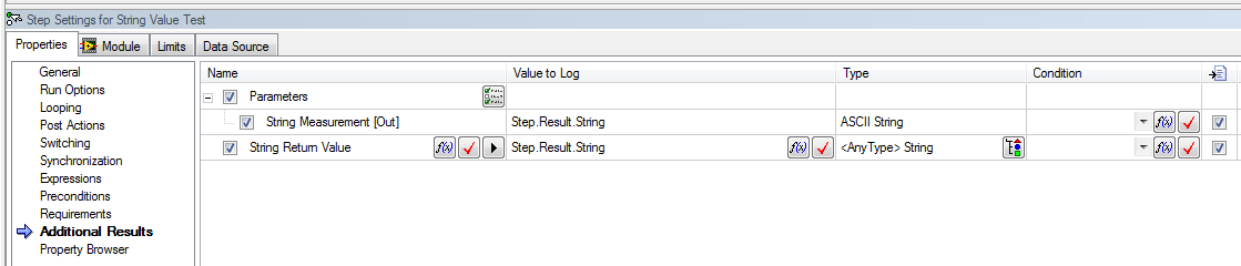

What exactly do you mean by "key values"? Are you referring to the Key property in the NI_SimpleTextReport_CVI.seq?
In order to get the comparison type of a Numeric Limit Test, for example, you could use a Post-Expression like the following:
Locals.ComparisonType = Step.Comp
This would return "GELE"
As for adding results to the report, the Key values are a look-up string relative to a Result object. In this case, you can add what you want to log to the Additional Results of that step. Then, you can add a new Report Column in the NI_SimpleTextReport_CVI.seq file and make the key value:
AdditionalResults["NameOfAdditonalResult"]

Thanks for your help with this, I can now find the data I want and have added it to the report. I have changed the cvi code to not output items with no data so I can have both string columns and numeric columns and only the relevent ones are in the report.
