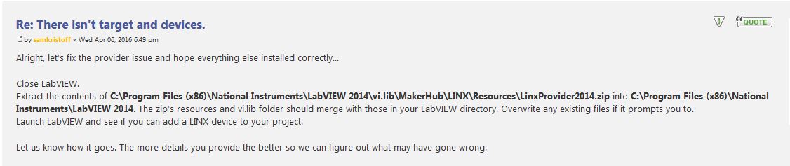

Merhabalar,
Çok şükür hallettim :))
Çözüm:
https://www.labviewmakerhub.com/forums/viewtopic.php?f=12&t=1379&start=10
