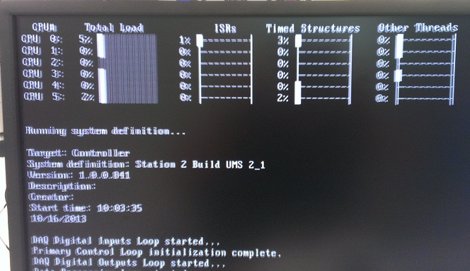

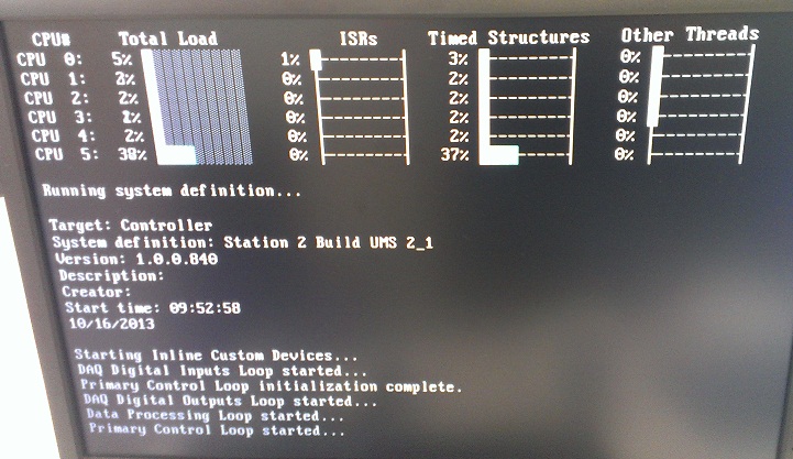

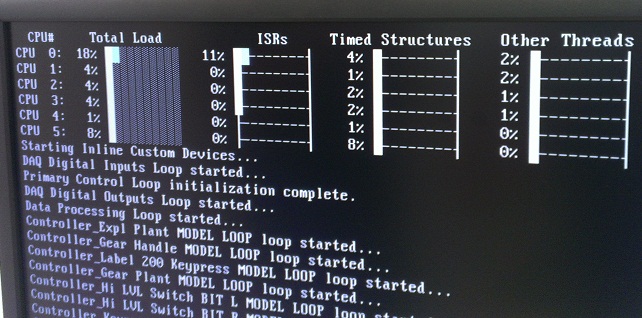

One thing I forgot to mention is that with VS2012 (loop duration of 3750 usec), on the RT screen we see that one of the CPUs is at 38% with 37% under Timed Structures.  When running the same project on VS2011 (loop duration of 635 usec), the highest CPU is at 18% with only 4% under timed structures.  If we disable the A429 custom devices and run again on VS2012 (loop duration of 290), we get hardly any CPU load at all (highest core is 5%, timed structure of 3%).  So it seems that the custom device behaves differently in VS2012 compared to VS2011.
VS2012 with A429 (high timed structures):
VS2011 with A429 (hardly any timed structures):
VS2012 without A429 (hardly any timed structures):
