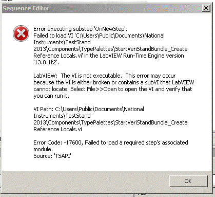

Kevin,
I've run into an issue trying to get this working with VS and TS 2013.  I get the following error when adding the "Initialize VeriStand" step into Setup.  I have manually configured adapters per earlier in the forum.

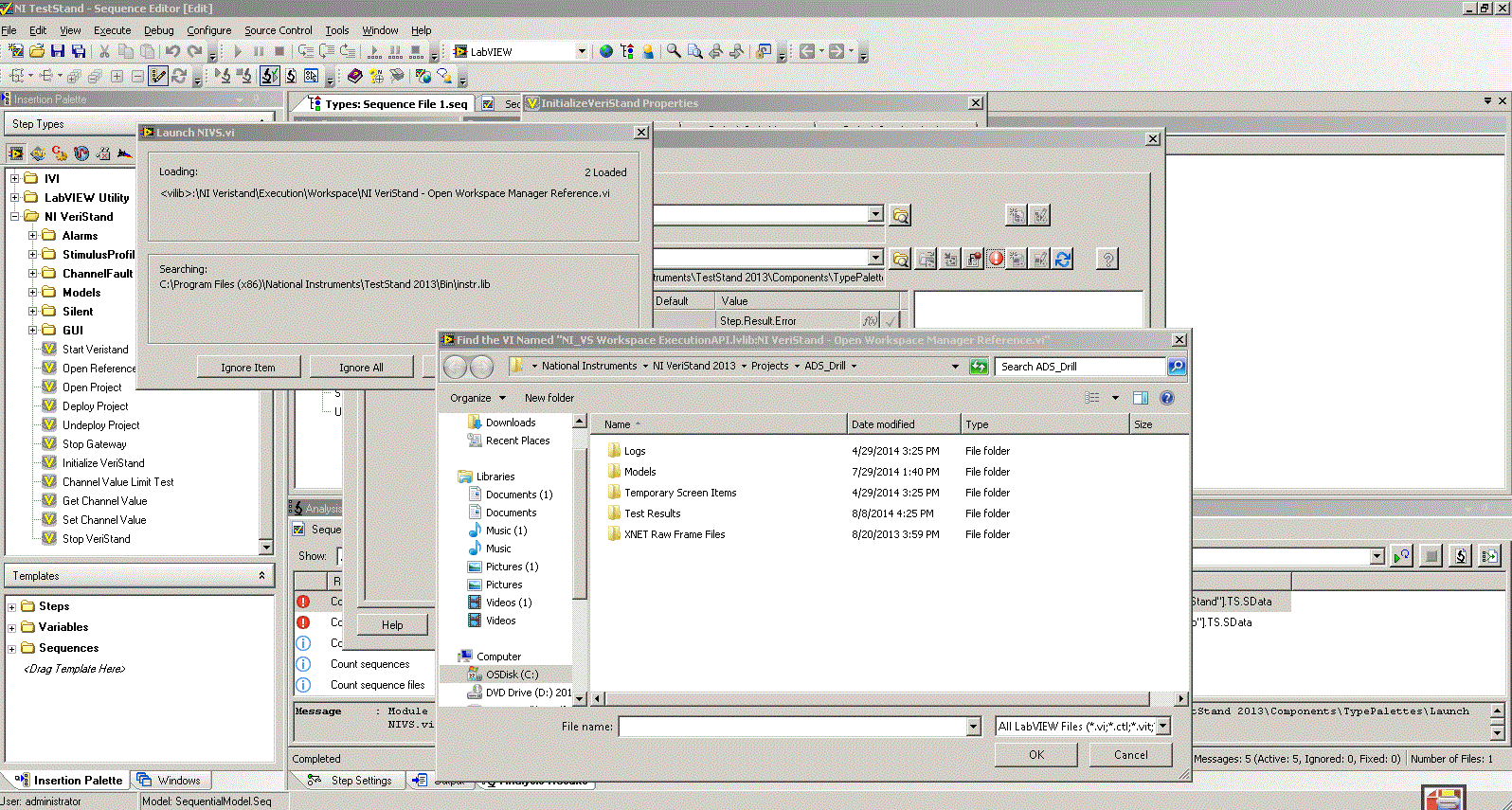

I try to run it from within TS, and it seems I'm missing some library VI's:
Message 155 of 202
(1,029 Views)
Hey Jeremy,
The first error message has a path to a VI. If you open up that VI in LabVIEW on the machine do you see any errors - does the VI have a broken run arrow?

I don't have labview installed on this machine to see if it's broke.  Is there another way?
Message 157 of 202
(1,029 Views)
That might be the problem, Someone else told me recently they were having trouble getting Initialize VeriStand to work correctly without LabVIEW installed. Theoretically I think TestStand should be able to call all the VI's without an installed version of LabVIEW but for some reason that wasn't working for them. I didn't get time to figure out what was wrong on their machine but I can probably set up a test machine here to see if I run into issues without LabVIEW installed.
