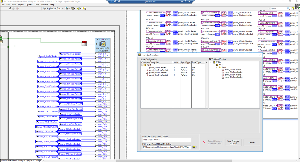

When I double click on the node I only see the first 4 signals that are mapped. All I am doing is measuring PWM Input frequency and Duty cycle which are 64 but unsigned numeric. Only the first 4 shows up and I get the error codes 1055 and 1136 as shown below. I have also attached a snapshot of the code. Any suggestions?
Date: 3/18/2019
Time: 2:16 PM
Error: 1055
Error Source: Property Node in Double Click Tree Read Tree subVI.vi->Node Configuration.vi->FPGA XML.xnodeSmiley SurprisednDoubleClick2.vi->FPGA XML.xnodeSmiley SurprisednDoubleClick2.vi.ProxyCaller
Date: 3/18/2019
Time: 2:19 PM
Error: 1136
Error Source: Property Node (arg 1) in Double Click Build Tree SubVI.vi->Node Configuration.vi->FPGA XML.xnodeSmiley SurprisednDoubleClick2.vi->FPGA XML.xnodeSmiley SurprisednDoubleClick2.vi.ProxyCaller

Hmm, odd. Two quick thoughts:
1. I'd recommend a different approach. This node, and VeriStand's native FPGA implementation in general, is meant for data synchronization with the PCL. However, this doesn't matter for asynchronous operations like PWMs. You're better off looking at something like the FPGA Add-on custom device that accesses the bitfile directly vs using DMAs.
2. If you really want to use the node, I didn't look too closely at your code but it looks like you're treating them as PWM inputs instead of direct U64's. The PWM input types assumes the data is a joined representation of high and low (see documentation pdf on downloads page). I don't know if the node was stress tested for high counts of PWMs, but I've seen implementations with high integer counts so that should work.

Hi Ryan,
I tried using them as U64 as well but it still stops populating after 4 signals which is odd. The following shows what manipulation I am doing to get freq and dc packets. This is how our current project is implemented in NI 2013 versions but without the FPGA XML Builder, it was done using DMAs in the actual code. I tried to use the FPGA XML Builder Node to help create the fpgaconfig file automatically without having to manually create it. I have created a different project where I just use the NI RIO LIB for PWM available in the NI Veristand FPGA Support Palette which when wired to the PWM input of the FPGA XML Builder Node works fine, now I need to figure out what math i need to do in the system definition file to get the Freq and duty cycle value.
