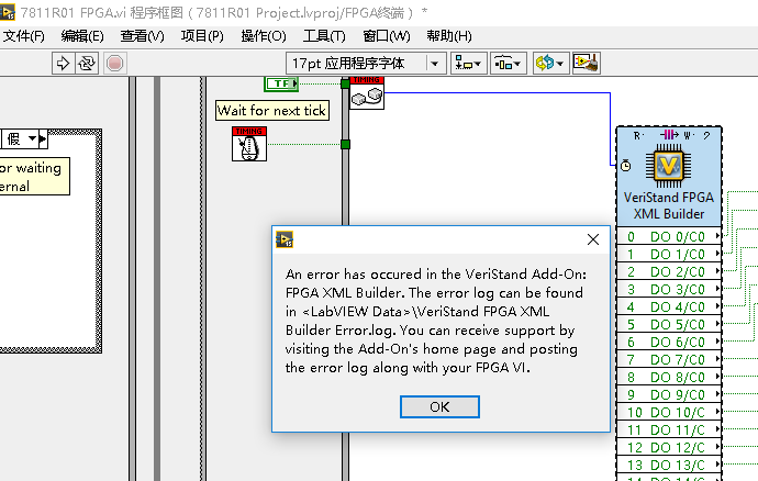

2) After I romoved the several PWMout node, the Run button becomes normal, but when I click the ”Accept Changes &Generate XML”, then prompts an error so that it can not generate an XML file.
Please see the relevant project” 7811R01” about this phenomenon.

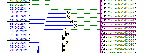

3) When the number of DO exceed 64,the Run button becomes abnormal, but can generate XML file.
Please see the relevant project” 7811R02” about this phenomenon. In this project, if you remove “Output_66” and Connector1/DIO24, the whole program will become normal (the Run button is OK, also can generate XML file)

It turns out you're the first person to try and send more than 64 boolean channels from VeriStand to the FPGA using this node. There is a bug in how we're scripting the code that isn't properly handling having more than one packet worth of booleans. As for the XML generation error you were hitting, that is likely Known Issue #5 on the node overview page.
I've added this bug as Known Issue #6. I've also listed several possible work-arounds you can use.
If you have questions on the work-around options, or how to implement one of them, let me know.
Hope that helps! --Ryan_S

Hi Ryan_S,
According to your suggested solution“Known Issue #6/Workaround Option #1”,I have solved this problem.Thank you so much for your help.
