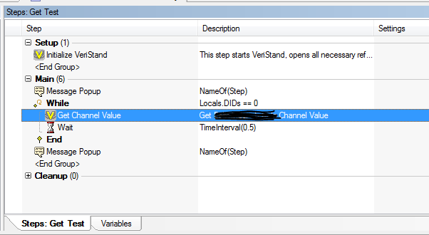

Hi HandyAndy
I'm running into some issues when creating a teststand sequence using the Get Channel Value step;
I used this Get Channel Value step in a while loop, to read a boolean signal from my Veristand project ( I assigned the channel value to a local parameter in Teststand). I was trying to make the while loop continuously reading this channel, and when it gets changed from 1 to 0, the teststand sequence would move to the next step. However it didn't work for some reason, can you help? Or is there a better way to do this than using the Get Channel Value?
Thanks!
Chen

Hi Chen,
This should work. In what way exactly was it failing to do what you expected?
Here's a screenshot of a very simple sequence which initializes the VeriStand Engine Demo shipping example and then waits for a channel to change value from 0 to 1.
Have you double checked the logic in your sequence?
I hope this is helpful!
Andy

Hi Andy,
Thanks for the quick response. The logic seems correct in my sequence.
And actually, in my application, I'm using the Diagnostics Addon custom device in Veristand to read the signal, although the signal itself is boolean type, while due to the custom device it becomes numeric value when use Get Channel Value step in Teststand.
I created a test sequence just like what you showed above, somehow the change of Get Channel Value from 1 to 0 does not stop the while loop from going. Do you have any suggestions? And can you also explain what's the post expressions is doing here in your sequence? Thanks!
Chen
