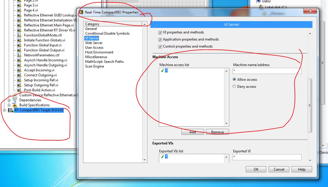

Also verify the network access on the target properties.

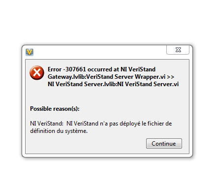

I tried to run this custom device on VeriStand 2017, but I obtained:
Is there any way to run it using 2017 versions?
