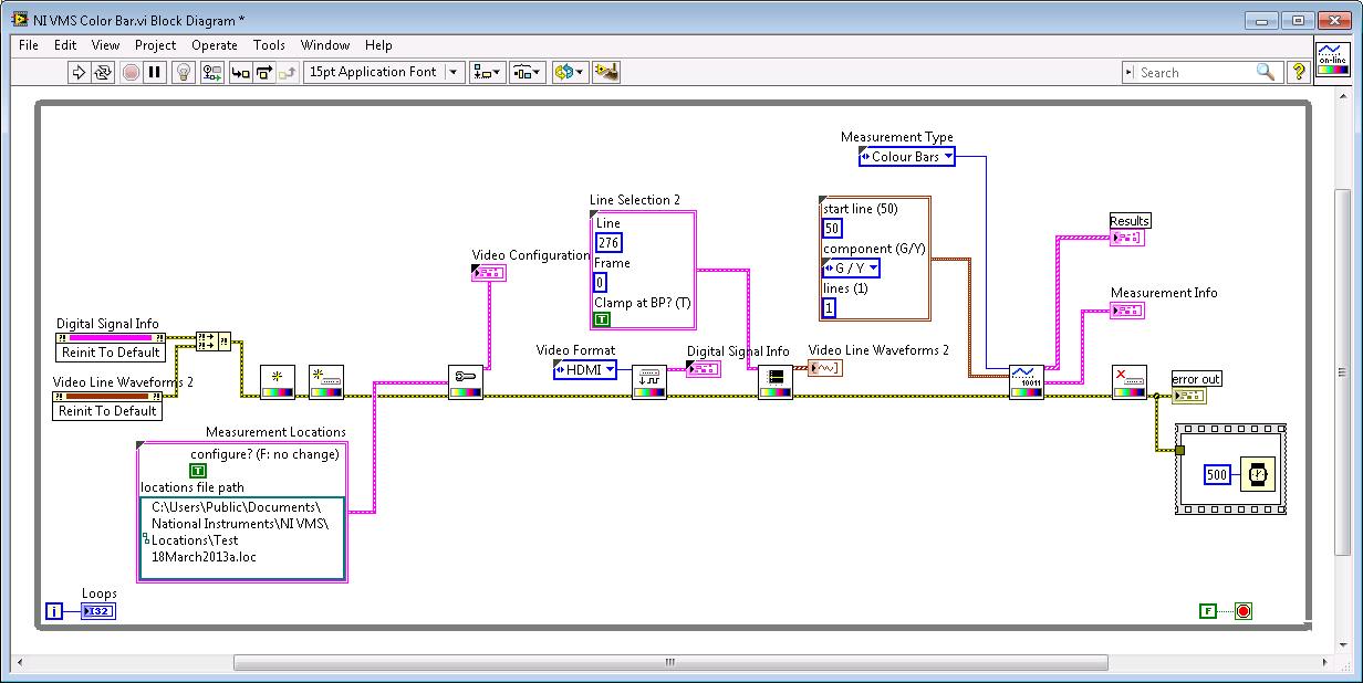

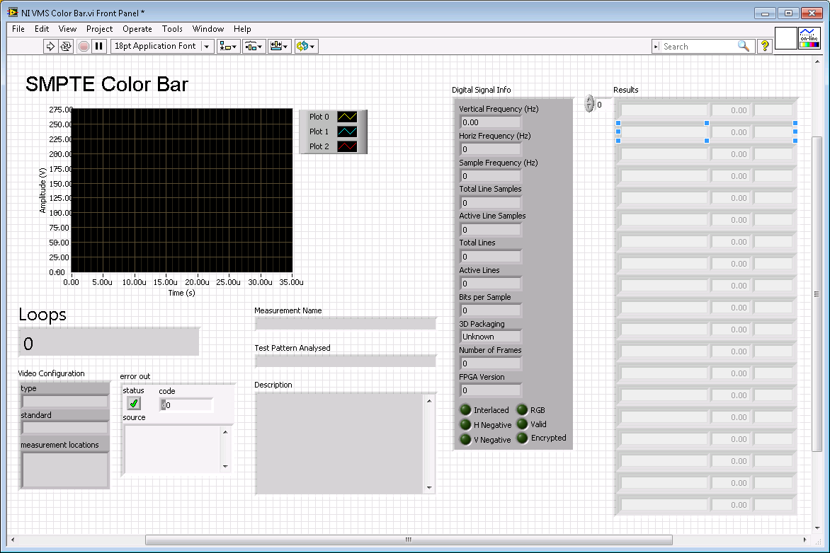

I currently have an application that makes color bar measurements.  This VI (seen below) was quickly written just to see how well it does a color bar measurement.  One thing that I realized is that I can't programmatically select a different video analyzer.  Our test setup will actually have multiple video analyzers (PXIe-1491s) in one PXIe chassis and I will need to run VMS functions on different devices.  From what I'm seeing is that there is no way.  In case you are wondering why I just simply don't use an HDMI switch is because we are already one but we have time requirements that need us to test X amount of units per time.

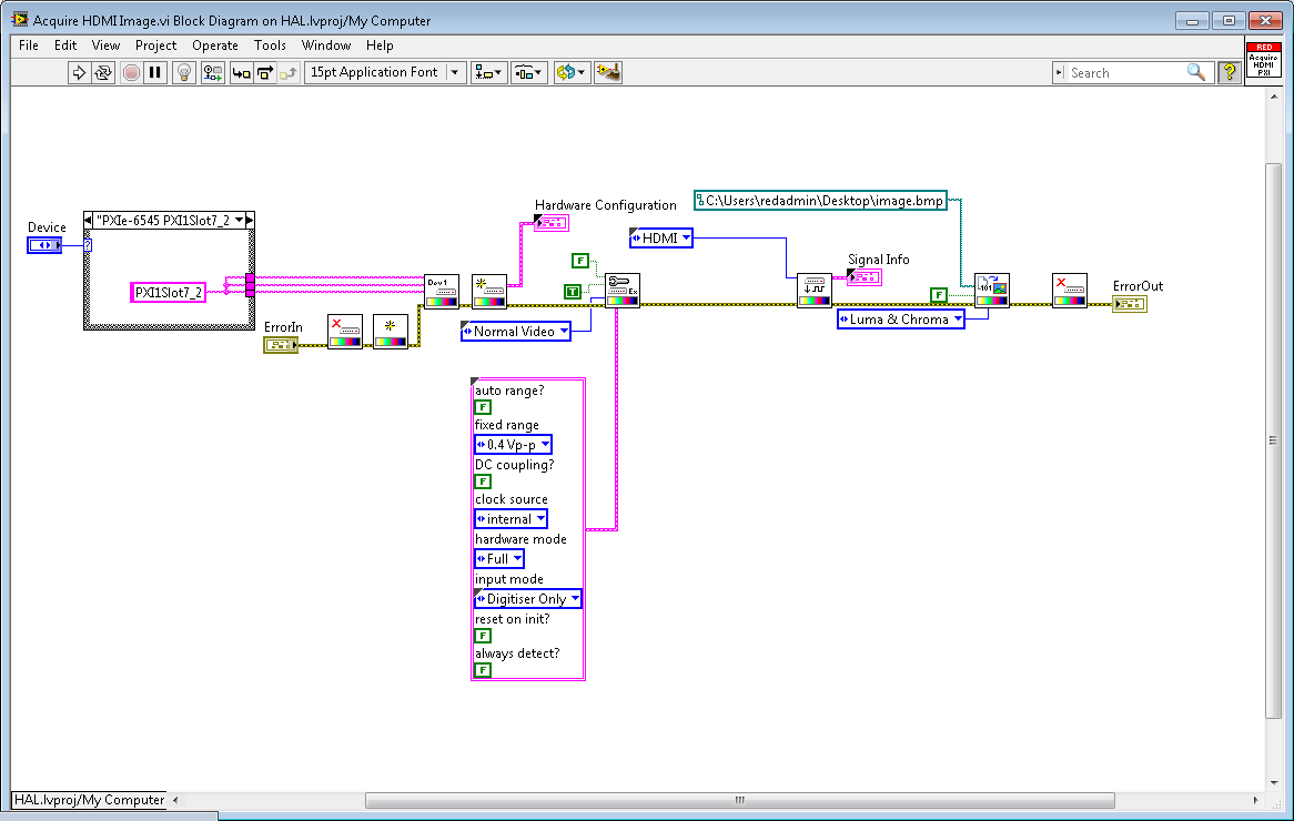

I have attached a VI that appears to work.  The VI acquires an image from either a pxie-6545 or pxie-1491.  I can select from a PXIe-6545 or a PXIe-1491 and acquire and image.  I will next try and see what happens when I try to acquire and image from each device simultaneously.

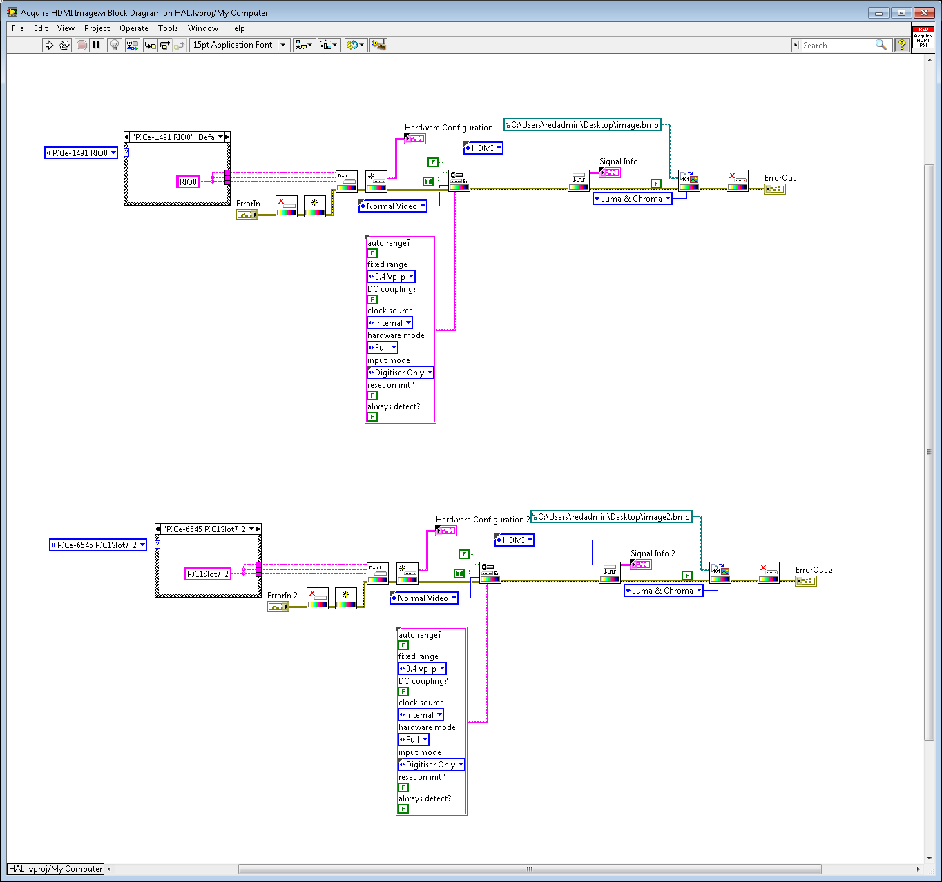

I tried the VI what I have previously posted to acquire 2 images simultaneously from a different device and I saw this error, "niMMT Manager - Handle Repository.vi, possible reason: niMMT Manager error: niMMT handle has become invalid. This could be because the first niMMT caller has stopped execution."  I get the impression that the VMS LabVIEW API can't handle simultaneous calls.
I have attached a screenshot as well as the VI.

Please let me know how this goes DaniellD, but I don't believe we can have simultaneous acquisitions.  The VMS VIs pull the hardware information from the configuration file Video Hardware.ini.  I don't think there is a way to specify multiple devices at once within this ini file.
