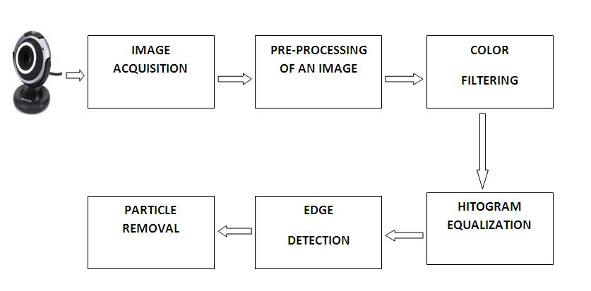

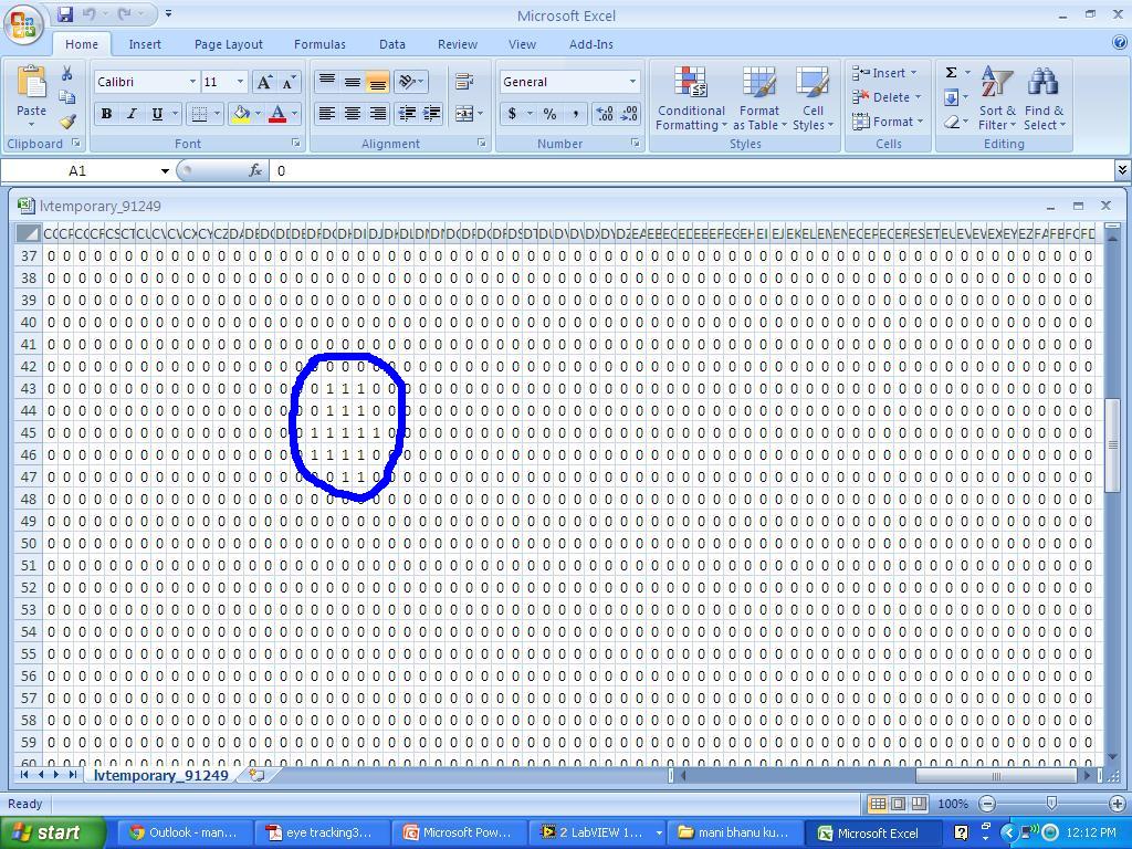

                    The methodology used is based on the output of the implemented houghman Transformation for circle detection to sense the image of the eyeball using a camera mounted on a headgear and continously work upon thevideo frames to detect the relative position of on a matrix to trigger the cursor movement across the screen.
Description of Project:
The main reason for using this technique is the complete absorption of the IR rays into the cornea of the eyes so as to eliminate specular reflection caused when visible light is used instead.This yields resulting with excellent accuracy by the image processing module we use to detect the center of the cornea to obtain its coordinates.
