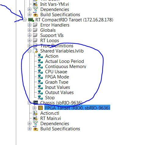

I attach some screens from my project. I am quite sure the shared variable library is in corect place.
(However - it is hosted under the target but not under FPGA target - could this be the problem?)

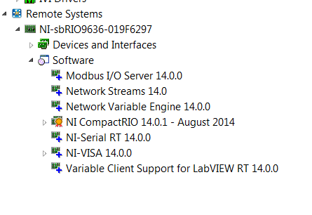

I have some other thoughts triggered by a different issue - I had a huge amount of trouble(and frustration..) implementing serial communication with the Evaluation platform. (RS-232)
Eventually (and thanks to this forum...) I realized that I had to install VISA drivers on the real time platform. . These drivers were not configured to be installed by  default in the evaluation kit installation
Could it be I am missing some additional installation, that influence shared varabels performace? I attach a screen-shot of current software installed on the RIO platform.

Confirming based on your screenshots that the variable library is properly hosted on the real-time processor and you have the correct software support installed (Variable client support and network variable engine).
