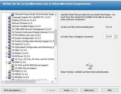

We have a PXIe-1088 chassis with a PXIe-8880 controller currently running PharLabs as OS. On our host we updated LabView+Veristand from 2019 to the most recent version (2021 R2). We updated the drivers on the PXI-target accordingly but the VeriStand RT Engine is missing and it cannot be installed (it does not appear in MAX when clicking on "add/remove software"
I would appreciate feedback how to solve this problem.

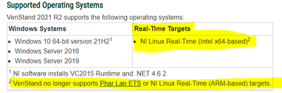

In fact, it turned out that the problem arises due to the fact that PharLabs is not supported anymore:
VeriStand 2021 R2 Readme
