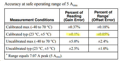

I am looking at NI-9227 C series module. it says the following:
50 kS/s/ch, 5 Arms, 24-Bit, 4-Channel C Series Current Input Module
So, whats the resolution for this card? Can I measure 10 uA DC current?

An ideal choice to monitor power is powering up the UUT using an SMU and monitoring the current.
The offset and gain errors are at least 14mA (0.05% of 14 A-pk * 2)

If you switch to TestScale, you can get the TS-15200 module.
