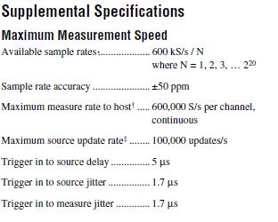

The maximum source update rate for the PXIe-414x is 100 K samples / s and can be found on page 4 of the specification.
