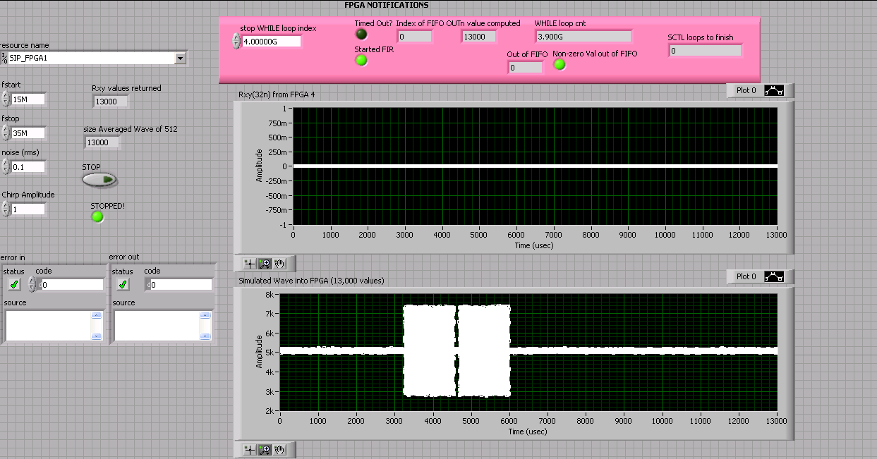

The problem is that when I run this code the output I receive are all zeroes.  I have included a graph below which shows some good pointers as to what is going well:
    • Non-zero data is going into the FIFO as shown by the "Simulated Wave into FPGA (13,000 values)" waveform which is taken right before values are put into the "hstTOfpga" FIFO
    • the "FPGA Notifications" section shown in pink shows that the "n value computed" indicator reaches a value of 13,000 which implies that 13,000 values have been placed into the "fpgaTOhost" FIFO as this indicator is only incremented when the case structure has a TRUE case
    • Even though the "Out of FIFO" indicator in the FPGA Notifications section shows all zeroes, I created a latch which searched to see if this indicator is ever non-zero.  This LED is turned on showing that at least 1 non-zero values was read of of this "Out of FIFO" indicator which is what goes into the IP Node in the FPGA code shown above (shown as "Out of FIFO" in Figure 2 above)
Fig 3. Host Front Panel After Simulation
