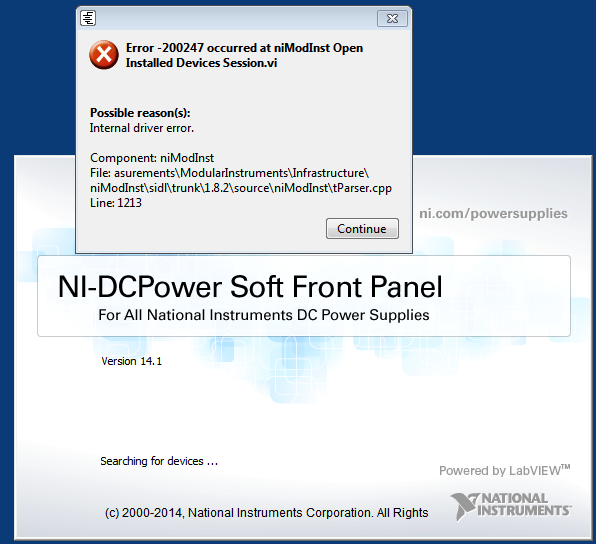

I am having trouble opening the ni DC power soft front panel. The error message I repeatedly am seeing is below:

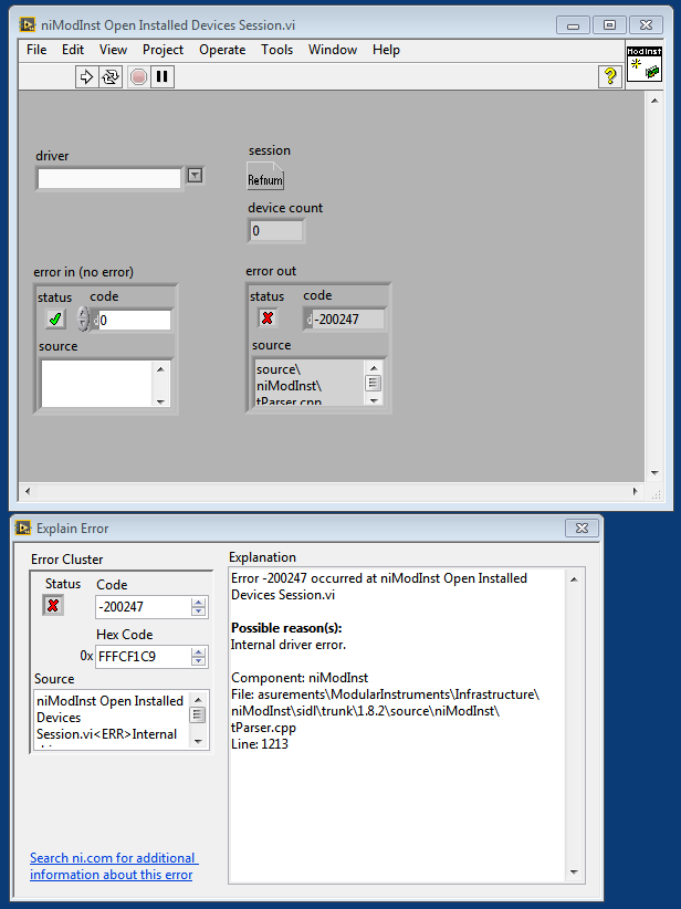

When I try to run the vi mentioned in the error above, the same error occurs:

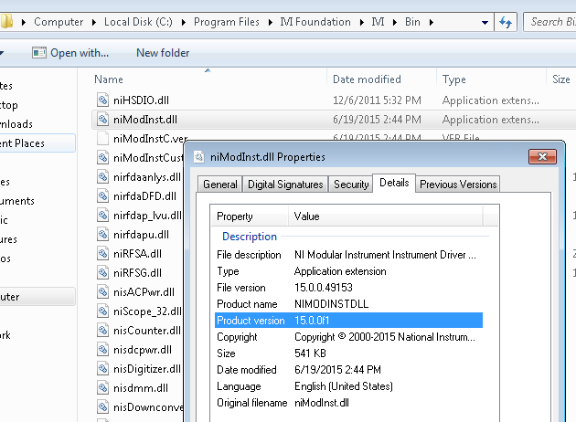

Also, can you check which version of niModInst.dll you have on your system?  This file can be found here: <Program Files>\IVI Foundation\IVI\Bin\niModInst.dll
Right-click on the file, select Properties, and then click on the Details tab.  The information I need is the "Project version" field.  See the image below:
