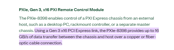

So, as per the documentation, you can theoretically go up to 16GB/s
You mentioned of the sampling rate up to 90kHz but failed to mention the actual instrument and number of channels.
